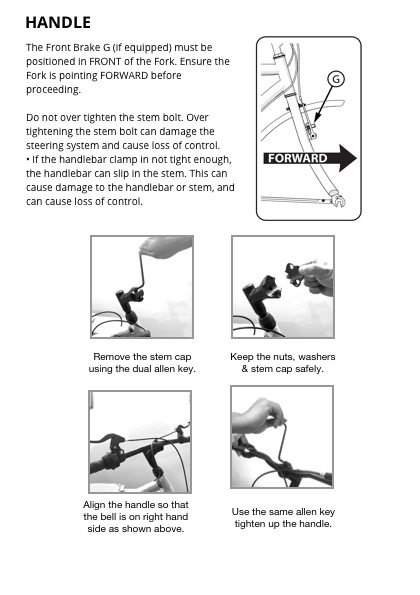

Assembly
Common Issues
If the handle is not tightened properly, if might start getting loose every time rider takes a turn while riding. This can be very dangerous and can lead to unwanted incidents. Hence, if you feel that your handle is not getting tight properly, take professional help.

Is the Handle Adjustable?
The handle assembly is a quill type, threaded assembly. Rider can increase the handle height as per their requirement upto 3 inches (from the default position).
